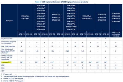

The information can be found in AN4879: Introduction to USB hardware and PCB guidelines using STM32 MCUs and precisely table 5:
Regarding your proposal for the product selector: I'll raise it internally.

Hi @yakabmarci ,
-Amel
2023-11-09 9:18 AM

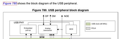

seems there is an error in the table: H563 has FS phy internal. - but not in this table.
from rm :
2023-11-10 2:26 AM
Good catch @AScha.3. I reported this internally.
Internal ticket number: 166032 (This is an internal tracking number and is not accessible or usable by customers).
- Amel
