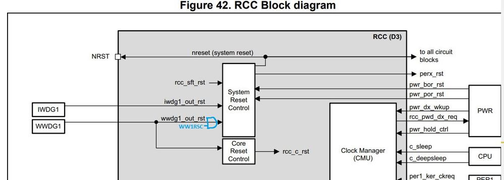

The STM32H753 reference manual section 8.4.2 Figure 43 shows that a watchdog reset will cause a transition on the external NRST pin, as will a software reset.

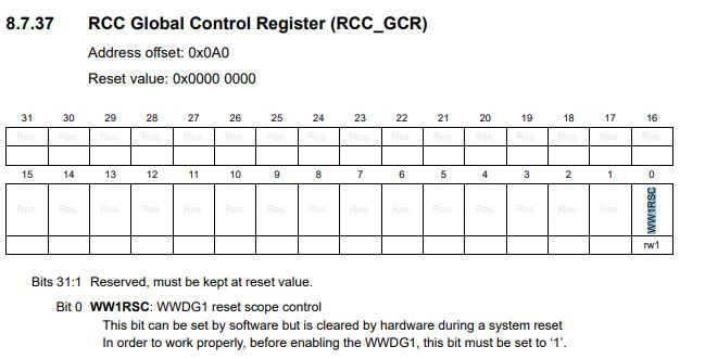

}Reference manual says WW1RSC bit must be set in a roundabout way:
The bit description for WW1RSC does not actually say what it does.
A picture says a thousand words. This would have made it so much more obvious!

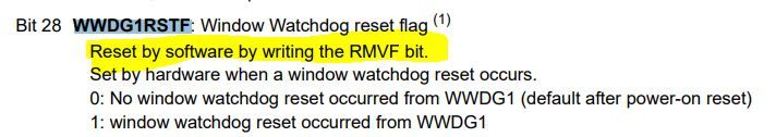

The WWDG1RSTF flag is not allowed to be written by software. You can read it to see the cause of a reset, but must clear it by setting the RMVF bit. HAL provides the __HAL_RCC_CLEAR_RESET_FLAGS(); macro for this. And if (__HAL_RCC_GET_FLAG(RCC_FLAG_WWDG1RST) == SET) ... for reading.

The reason behind this bit becomes clear when cross-checking RCC_GCR with the H745/H747 RM as these devices are actually the same as the H743 (except that the M4 is disabled on the H743): If it is cleared, only the M7 is to be reset, not the M4.

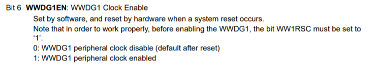

Besides to the "Caution" added in the RM and already mentioned in this discussion, we have the following description for WWDG1EN bit:
This said, it may remain not enough clear and requires farther explanation in RM. I'll raise internally other requests for documentation updates asked by Jan.

It would be great if the reference manual just stated what the WW1RSC bit does. E.g. WW1RSC must be enabled before enabling the WWDG1 to ensure a watchdog reset will cause a system reset rather than just a CPU reset. Or link to the WWRSC1 description and have that be clearer about its purpose.
