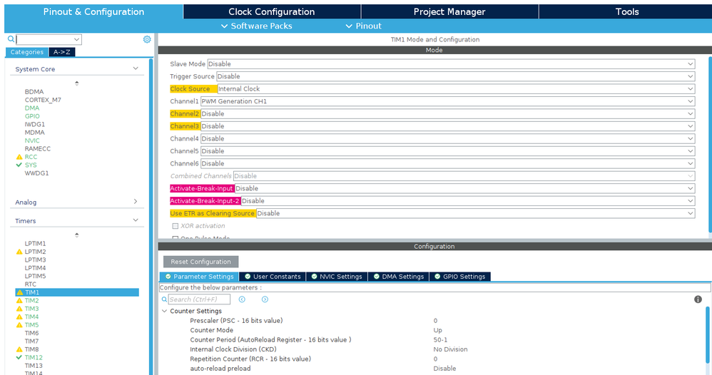

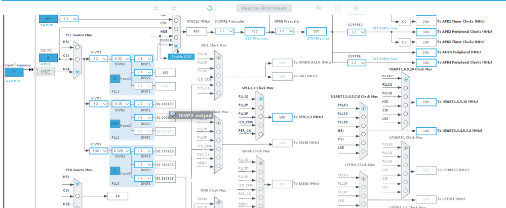

I am attempting to use TIM1 CH1 to produce a 4MHz PWM with 50% duty cycle, to be used as a clock input to a knock sensor.  TIM1 is on the APB2 Timer Clock with I have configured at 200 MHz:Screenshot from 2024-06-06 14-08-56.png
To get a 4MHz frequency I have PSC = 0 and the ARR/Counter period 49:

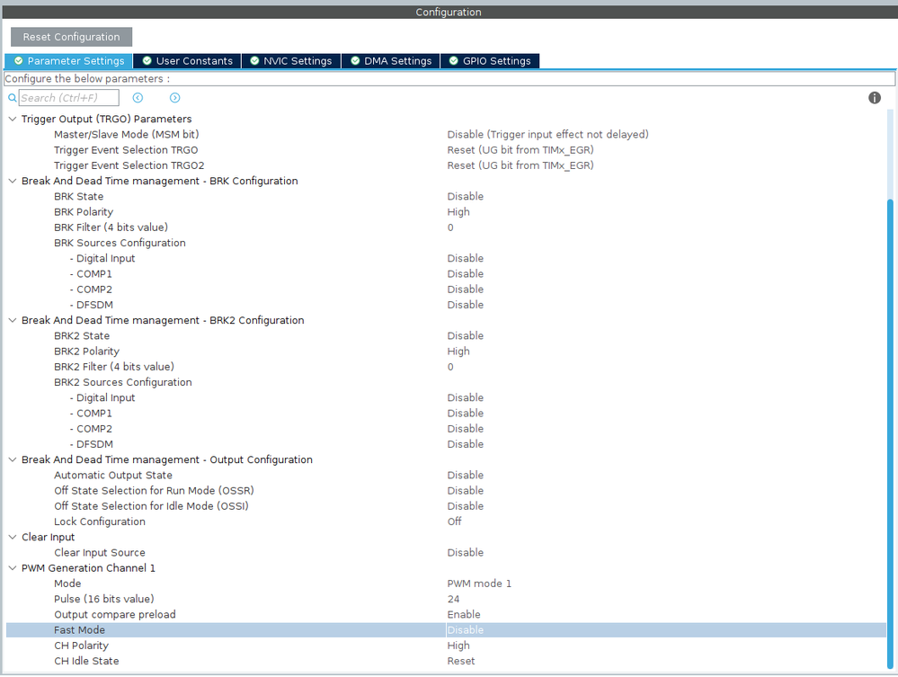

Here are the rest of the settings for break and dead time (not used) and PWM Generation Channel 1:
