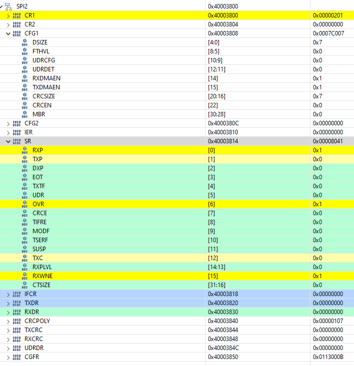

HAL_I2SEx_TransmitReceive_DMA (1.9.1) is used. The init order is not as described in the Reference Manual RM0455 Rev 7, page 2115. I also tried the Ref.M. order without success.

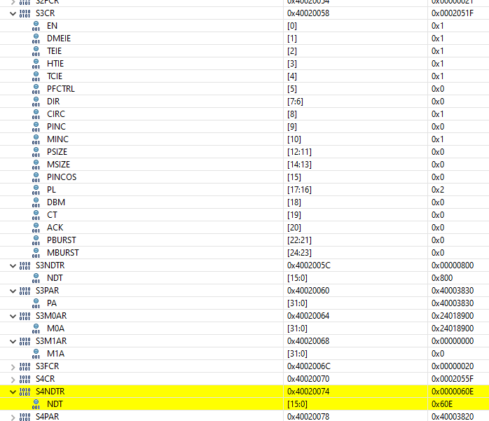

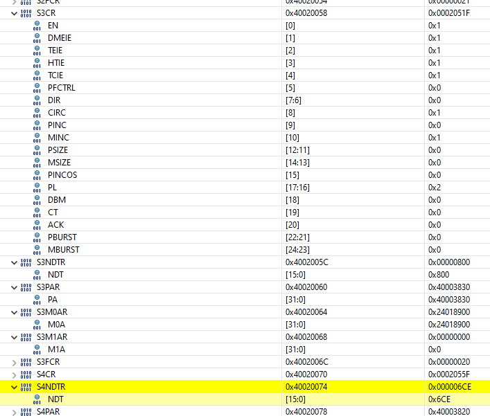

The following image shows the SPI2 registers after start The following 2 image show the state of the DMA1 Steam3 (RX) and Stream4 (TX) about a second from each other. The Stream3 NDT stays on 0x800 whereas Stream4 counts.
What could prevent DMA1 Stream3 from starting? Any help appreciated! Thanks in advance.

Resolved: missed to set AudioStreamRxDmaHandle.Init.Request = DMA_REQUEST_SPI2_RX
