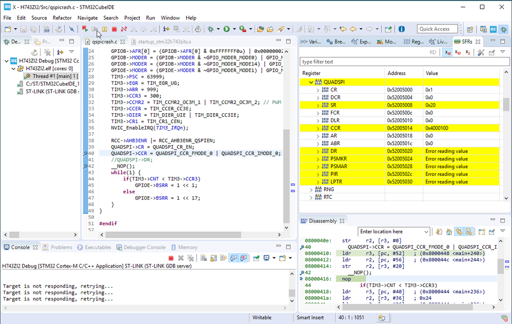

Executing this code sequence on a STM32H743ZI or STM32H743II
RCC->AHB3ENR |= RCC_AHB3ENR_QSPIEN;
	QUADSPI->CR = QUADSPI_CR_EN;
	QUADSPI->CCR = QUADSPI_CCR_FMODE_0 | QUADSPI_CCR_IMODE_0;
	QUADSPI->DR;
i.e. indirect read with only an instruction phase, then reading the data register freezes the MCU, i.e. no further instructions are apparently executed.
Debugger connection is lost, tries to reconnect a couple of times then gives up. I was able to reconnect the debugger only with Connect under reset enabled.
Watching the QSPI registers in the debugger has the same effect even when the DR register is not directly read by the code.
Workaround: avoid this sequence, use indirect write mode instead to send SPI commands with no parameters.

Just checked on Nucleo-H743ZI2: If DLR is cleared, BUSY bit sticks at 1, *no* other flag set. If DLR if set to 0xFFFFFFFF (the idea was that maybe BUSY is only cleared when transfer counter reaches 'nothing left' state) before writing to CCR, BUSY still remains set, but now TCF is set.
So, clearly, the BUSY reset logic has a flaw.
