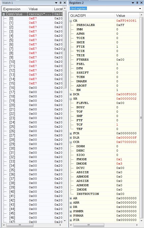

I am going to use stm32f722vc MCU and QSPI in my design. Before designing PCB I research QSPI on available hardware: board with stm32f722vc MCU installed and all GPIOs available on headers. I am trying to execute indirect read mode to fetch GPIOs states, as memory chip is not available by now.
Test code is
QUADSPI->CR = (255 << QUADSPI_CR_PRESCALER_Pos) | (0x00UL << QUADSPI_CR_FTHRES_Pos) | QUADSPI_CR_FSEL | QUADSPI_CR_EN;
QUADSPI->DLR = 63;
QUADSPI->DCR = 15 << QUADSPI_DCR_FSIZE_Pos;
QUADSPI->CCR = QUADSPI_CCR_FMODE_0 | QUADSPI_CCR_DMODE_0 | QUADSPI_CCR_DMODE_1;
QUADSPI->CR |= QUADSPI_CR_FTIE;
//interrupt handler
void QUADSPI_IRQHandler(void)
DataValue[DataCnt] = *((__IO uint8_t *)&(QUADSPI->DR));
DataCnt++;
So with code above I expect QSPI will read 64 bytes of states of it's 4 data lines. But the result is completely different. QSPI always reads a quater of QUADSPI->DLR value, that is 16 bytes instead of 64 regardless off data lines count used (DMODE bits). And the data QSPI fetches is completely not the lines states. I get only 0xE7 data bytes regardless of actual lines states (all lines coonected to GND or all lines connected to 3V3) and data lines count used (DMODE bits). Also FIFO settings do not effect data bytes. But transfer itself seems to be executed without errors, transfer complete flag arises, busy flag is cleared (picture attached).I have read documents about QSPI, but have not found the answers (or misunderstood them).

Hello @Amel NASRI (ST Employee)
Thank you for reply, I have read this one too.
Finally I managed to get QSPI reading data as it should, but only for the first bank, when FSEL = 0.
It is found out that I am faced with the very same situation described here https://community.st.com/s/question/0D50X00009XkWnQ/quadspi-read-with-data-only-phase-indirect-mode
Actually, as you answered in that thread, "QuadSPI could not be configured with only data phase activated in indirect read mode". Although that discussion and your answer regarded to STM32H7x3, it is found out that stm32f722vc has the very same limitation.
STM32F72xxx STM32F73xxx Errata sheet does not mention this limitation but in practice indirect read mode with only data phase activated does not work for stm32f722vc. The workaround you suggested (to enable the dummy phase with at least 2 dummy cycles) resolves the situation.
Please confirm or refute impossibility to use QSPI in indirect read mode with only data phase activated in stm32f722vc.
