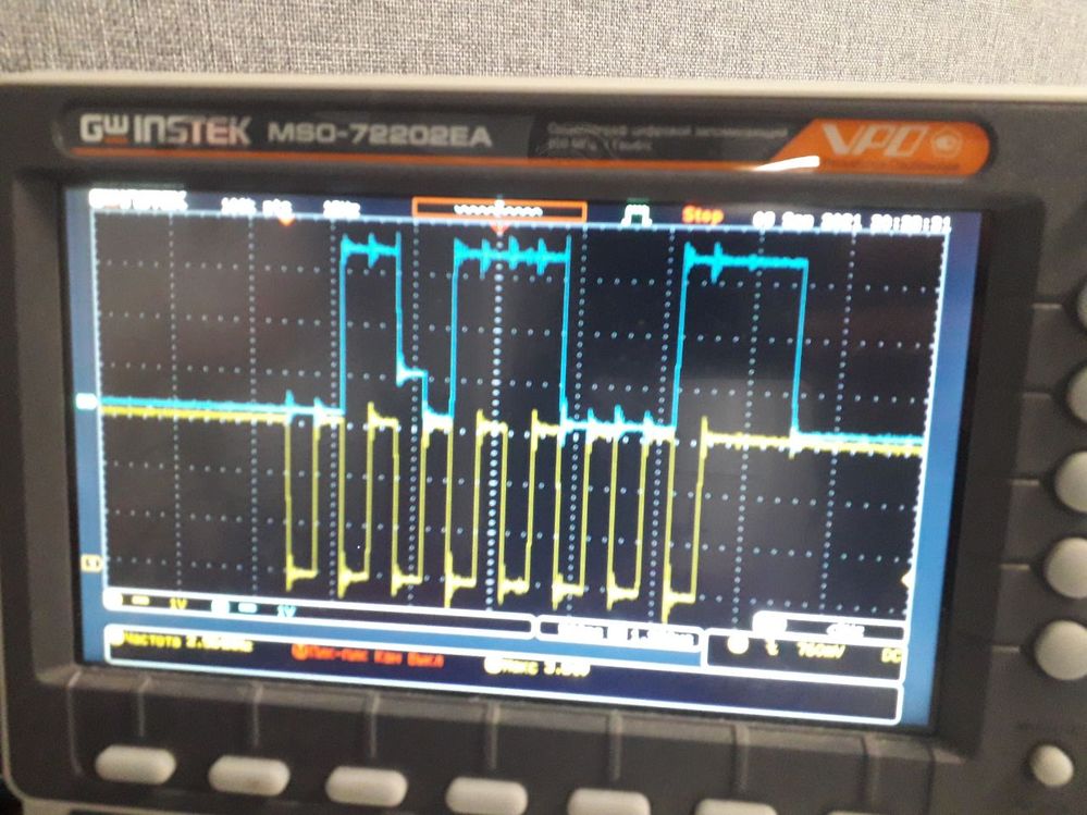

I have a problem when using QSPI with NOR flash. Some read commands return data with first 4 bits corrupted.
After investigation, I have found that the issue only appears if there is switch from output to input without dummy cycles.
For example (see picture): I send a 4-line, 1 byte instruction (2 cycles) and read 4-line 3 bytes (6 cycles). I expect IO2 (blue) to switch from output to input prior to clock's (yellow) third falling edge. Instead, it seems to be held at some grey level, that is sometimes sampled as 1 at the third rising edge.
Same issue was observed on STM32H7 with 2 different flash chips, using quad-spi and dual-spi.
Yellow is clock, blue is IO2
I can’t find something similar in errata.
Are some ideas, guys?

If it's in 1-bit mode why is the state of IO2 changing?
The state of IO1 would be more interesting, as would the clock edge you're sampling on. Tv is on the order of 7-8 ns
In QPI mode the QUADSPI peripheral may have a turn-around time also, I haven't dug into the specs.

Unfortunately the picture is rather bad (Your scope has USB and LAN, so most likely you could provide a screenshot?). What's the timebase? Keep in mind that most quad-capable flash chips allow only a rather slow clock for most commands, and the prominently advertised high clock rates only for a very limited set of commands like quad read, but *NOT* for the read id command. That's one reason why dummy clocks are necessary for the high speed reads. Some devices even don't support the 0x9F read id at all in 4-4-4 mode.

Sorry for poor quality picture, we will try to provide a better one.
For W25Q32JV there is no 4-4-4 mode indeed, but we see the same behaviour with a different command:
0xBB - Fast Read Dual I/O (https://www.winbond.com/resource-files/W25Q32JV%20RevI%2005042021%20Plus.pdf, page 31).
The issue is observed if last 2 bits of alternate bytes (M7-0) are set to 1 (for example, when we send 0xFF).
We tried to scale down the clock by 20x times, with no improvement. The clock on the picture is below 5 MHz. You can see that for entire duration of the third down clock, blue signal is held at around 1 V, which seems to be the root cause.
