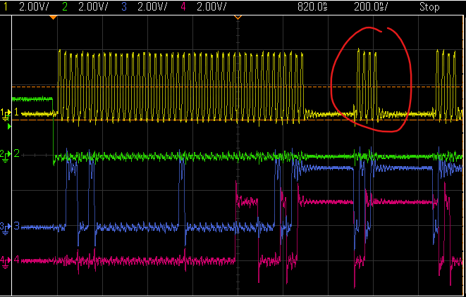

Regarding the QSPI waveform I'm puzzled whats going on during the flash read and programming sequence. This is the QSPI transmit / flash program (command 0x32) waveform:

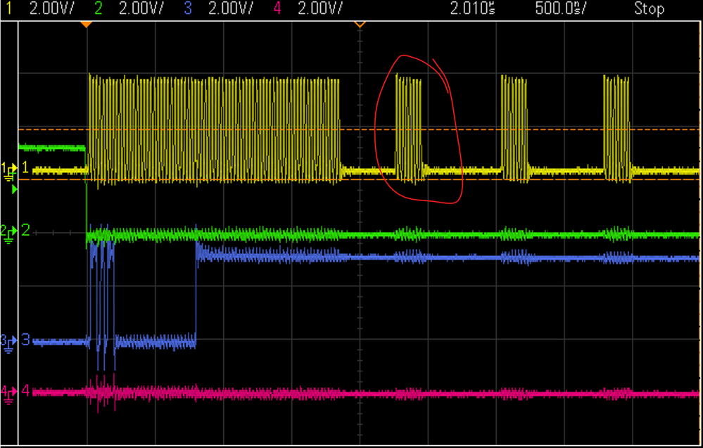

This is the QSPI receive / flash page read (command 0x6b) waveform:
In my understanding the command/address/dummy bytes are sent as expected.
But then the following data is split into 4 bit chunks during transmit and 8 bit chunks during receive. I have no clue why and which parameter is to blame here.

I ran the unmodified QSPI_ReadWriteDual_DMA on a STM32H753_EVAL2 board and got exactly the same results.
During
HAL_QSPI_Transmit_DMA
the SPI clock is paused after 4 or 8 bits if the SPI clock is higher than ca. 25MHz.

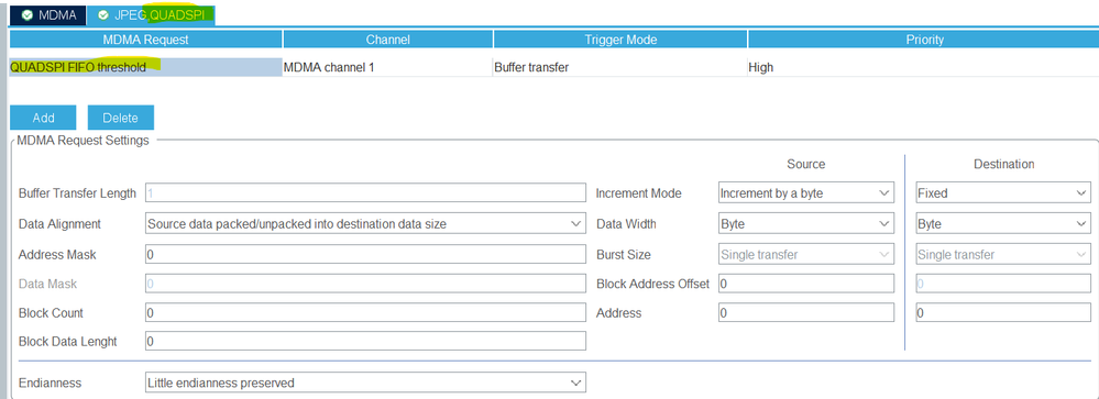

By increasing the buffer transfer length from 1 to 31 bytes, the bandwidth increases from ca. 11 to ca. 33Mbyte/s, which is still far less than the maximum possible DUAL QSPI transfer speed of 100MB/s @ 50MHz DTR. I wonder if OCTO/HEXA-SPI benchmarks can reach up 400/800Mbyte/s @ 200MHz DTR.
The funny thing is that CubeMx does not allow to modify this value.
hmdma_quadspi_fifo_th.Init.BufferTransferLength = 31;According to the RM this value can be in range 1...31 bytes.

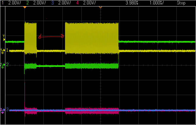

By increasing the MDMA granularity from BYTE to WORD the HAL DMA receive speed for one flash page read in QPI mode running at 50 MHz DTR for one flash page (256 bytes) has been improved to ca. 62 MByte/s.
Why not 100MByte/s? Looking at the scope, there is a pause of ca. 1500ns after ca. 20 clocks bus activity. This gap seems to be caused by the HAL function which first configures and runs the QSPI peripheral. The transfer stops when the fifo is full. In the meantime the MDMA is initialized and startet which is the second block of bus activity. The gap can be reduced by setting the optimization level to O3 but I guess it cannot be avoided without heavy code modifications in HAL layer.
