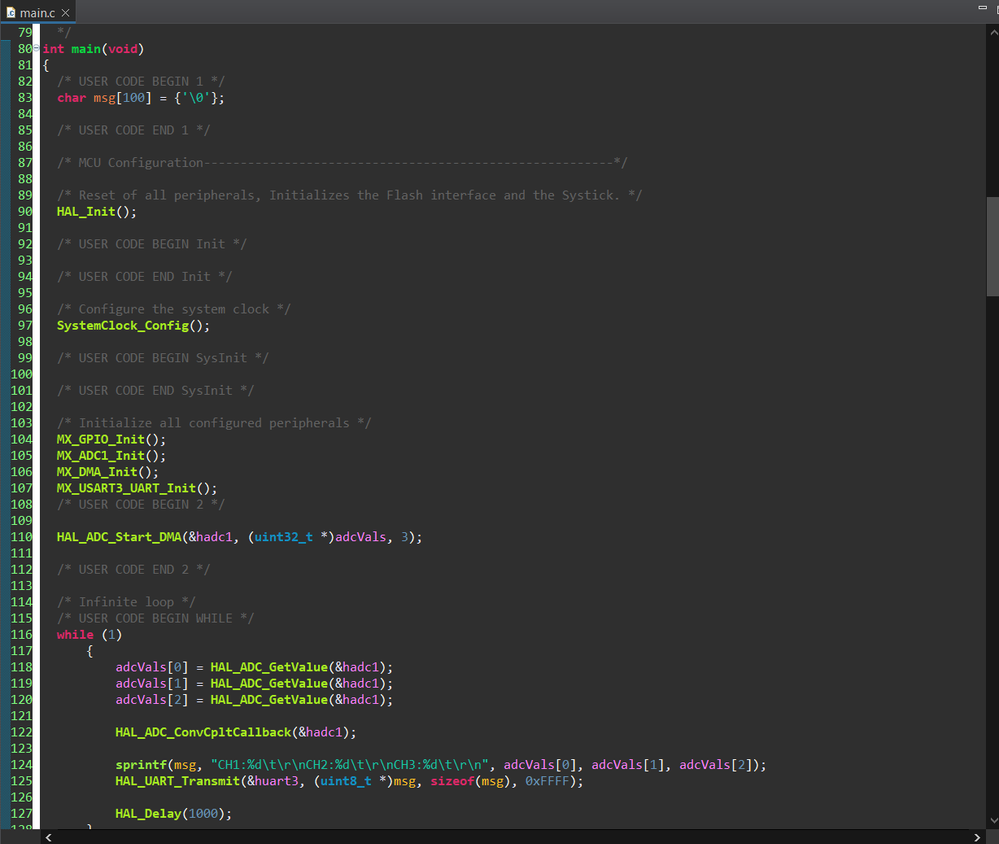

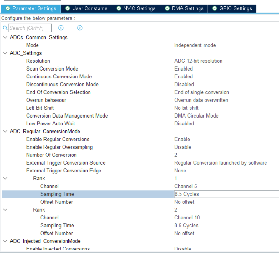

I'm having a very tough time getting more than 1 channel of an ADC instance using DMA to work on the Nucleo-H753 board. No matter what I try, nada... After rigorous debug, found that the ADC is NOT even starting when I call it to right before my while(1) loop... It saying that there is an internal error (17) and fails to start. This leads me to think that there's a config issue/error on my end. Any tips on setting up multiple ADC channels using DMA on the STM32H7 line would be greatly appreciated, as they have the fancier/more finicky 16b ADCs

have you been able to fix the problem? For clarification part of the problem of your code is linked to order of initialization of peripherals caused to a bug in STM32CubeMX as described in the thread posted by Piranha and solution described here. Further you initialize 2 channels, but in your code it seems you are interested in reading three channels and at last you are not supposed to use HAL_ADC_GetValue. In case of using DMA the values supposed to be in the specified buffer that you have chosen in HAL_ADC_Start_DMA.
You supposed to define function void HAL_ADC_ConvCpltCallback(ADC_HandleTypeDef* hadc). That will be called each time the buffer is filled with the new values. This is described in this video.

> I believe there should be a pop-up window at time of project creation in CubeMX asking the user to verify the silicon rev (Y or V)
This is not a popup window - at least not for STM32H7. The Y vs V stepping selection is in RCC -> system parameters.
