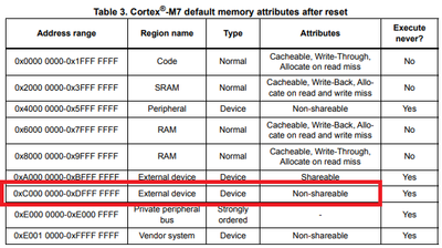

2025-03-23 7:31 AM - edited 2025-03-23 7:54 AM
The address 0xDXXX XXXX is not a cacheable region by default. Device means not cacheable even the caches are enabled (data and instruction).
The code you shared makes the 0xDXXX XXXX region cacheable.
So the results you shared are expected.
Hope that helps
