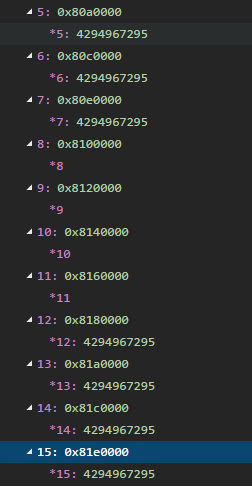

Debugger is also unable to access this memory as shown below:

If there's an ECC error, this would probably affect only several 8-byte blocks, not entire sectors (if they were not overwritten without previous erasure). Did you check this?
I guess PCROP was engaged accidentally for these sectors, that would cause the very symptoms you described.

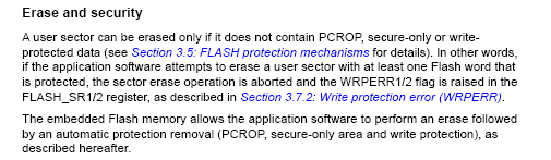

From RM0433 section 3.3.10
If you rush to recover by erasing (with protection removal) you'll not learn the cause.
At least connect using e.g. STM32CubeProgrammer and check the option bytes first.
