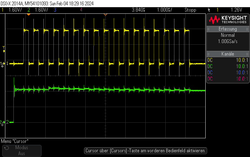

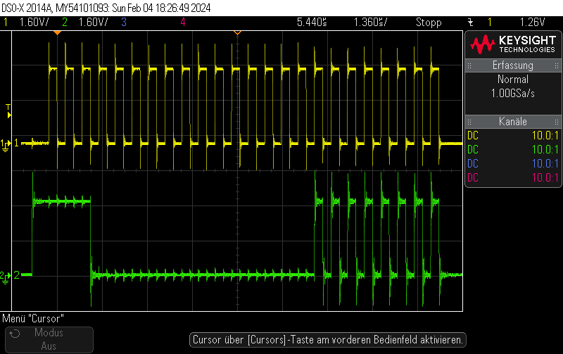

The commands are not failing (HAL_OK), but the Write-Operations are not working. Below you can see two images of scopes from an oscilloscope. The yellow line is the clock signal, the green RWDS. The read operation looks as described in the Hyperbus-Protocol (Command Frame, then 2x initial delay, then RWDS aligned with clock signal). The write operation however stops after the 2x initial delay. Can you find the error here?
Read operation
Write operation

We are running the Hyperram at 20 MHz for testing. For testing we created a Shield for the Nucleo and not really cared about the trace lengths. Do you think this could cause the problem? The strange thing is that the read operations seem perfectly fine.
Using memory mapped mode is not working too, reading seems fine (I cant prove the outcome because of the not working write operations), but writing statements are looking as captured above
