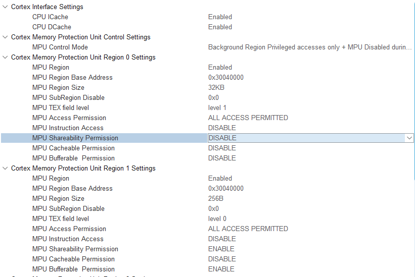

my defenitions of the MPU and cache:
as i understand it we are talking about completly different parts of the memmory.
