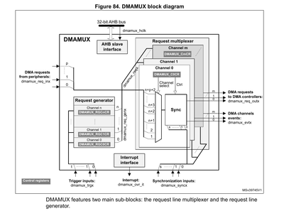

2025-10-23 5:25 AM
which H7 ? (there is more than one...)
If your H7 can...read in rm of it :
-- could use the dmamux , H743 ->
-- in Cube see:
-- or use MDMA :

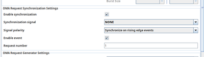

2025-10-23 6:33 PM
Hello
What effect does this Setting?
2025-10-23 6:39 PM
I don't see a reason to use two DMA channels. Even some timers doesn't have x30 address assign (RCR), shouldn't be any issue to transfer "null-dummy" data. Study this example.
