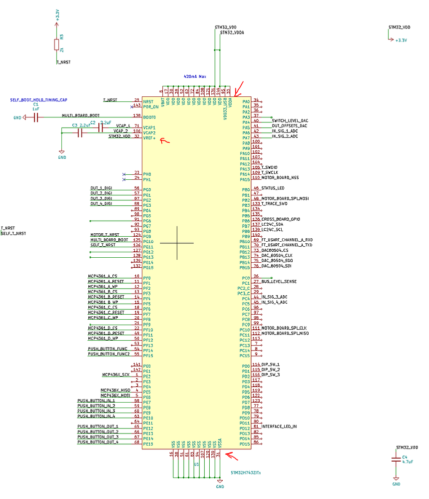

2021-04-04 5:41 PM
Hi JW,
Thanks for your reply,
I have VREF+ connected to 3.3v, same line as all VDD pins and VDDA.
I have VSSA/VREF- (Pin 31) connected to GND on same line as other VSS pins.
I am curious why would an unstable/moving reference would cause a bit precision error? does the hardware have/go into a "safety" mode?
weird thing is, I have seen the ADC work with LSB on a similar previous iteration of my board (with a similar power scheme). I am beginning to think I got a bad batch, I am usually wrong about that though.
