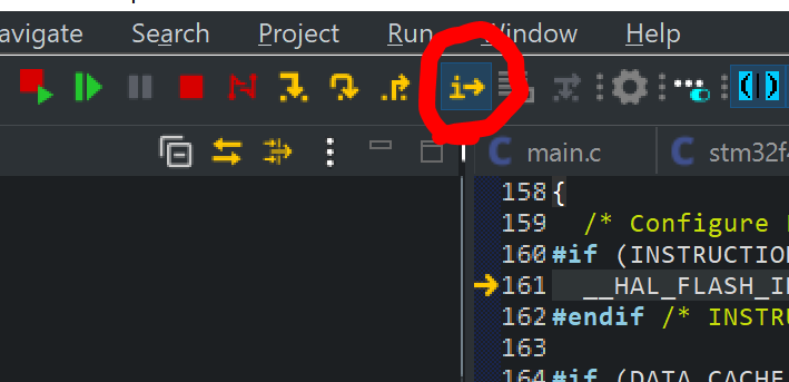

2021-11-18 10:12 AM
"Instruction Stepping Mode" can be enabled with this toggle. When enabled, the "Step Into (F5)" will single step through assembly code. When disabled, it single steps through source code.
I think something else is going on here though.
