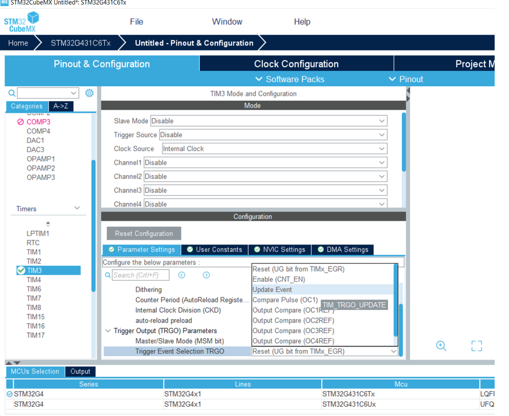

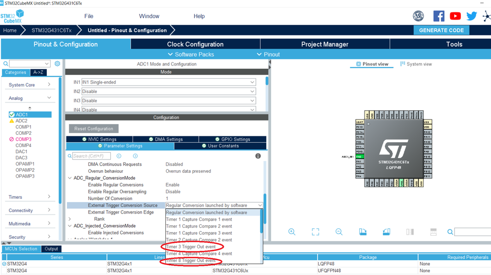

What i believe you want to do is quite straight foward and normal way of triggering ADC readings
Depends of what ADC youre using but if you go to cubeMX: you can see which timers have the option to trigger your adc conversions
Then you just configure your tim3/8/... to trigger event (it doesnt need to have any pwm channel on for you aplication)
