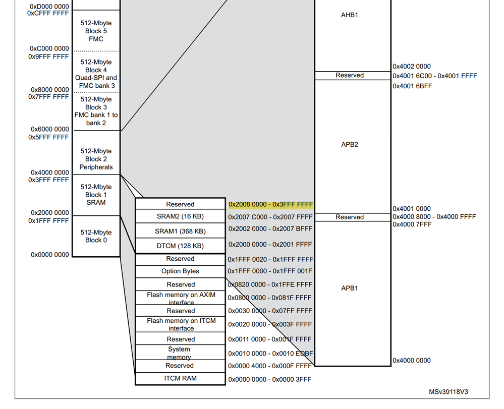

HAL_DMA_Start(&hdma_adc1,(uint32_t)&ADC12_COMMON->CDR ,(uint32_t)0x30000000, 6); // Start DMA.It is important to note, in case of using an F7, that you are trying to access a reserved memory ! as mentioned in figure below which is not the case for an H7 for example, So you should try 0x200000C4 for example.
