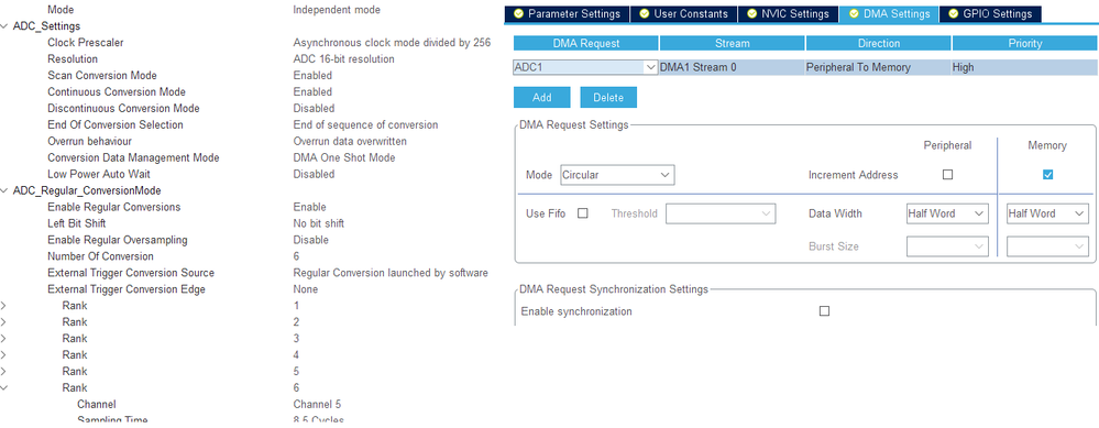

I tried many combinations of settings, but still could not get it working ADC with DMA. HAL_ADC_ConvCpltCallback() called only once when use HAL_ADC_Start_DMA(). But it work correctly when I use HAL_ADCEx_MultiModeStart_DMA().
Chip: Y STM32H743ZIT6U (NUCLEO-743ZI board)
HAL: STM32Cube FW_H7 V1.5.0
2019-08-20 12:00 PM
HAL_ADC_Stop_DMA() function change cfgr register:
/ Disable ADC DMA (ADC DMA configuration of continous requests is kept) /
MODIFY_REG(hadc->Instance->CFGR, ADC_CFGR_DMNGT_0 |ADC_CFGR_DMNGT_1, 0UL);This bits initialised in MX_ADC1_Init(), but not restored in HAL_ADC_Start_DMA().
