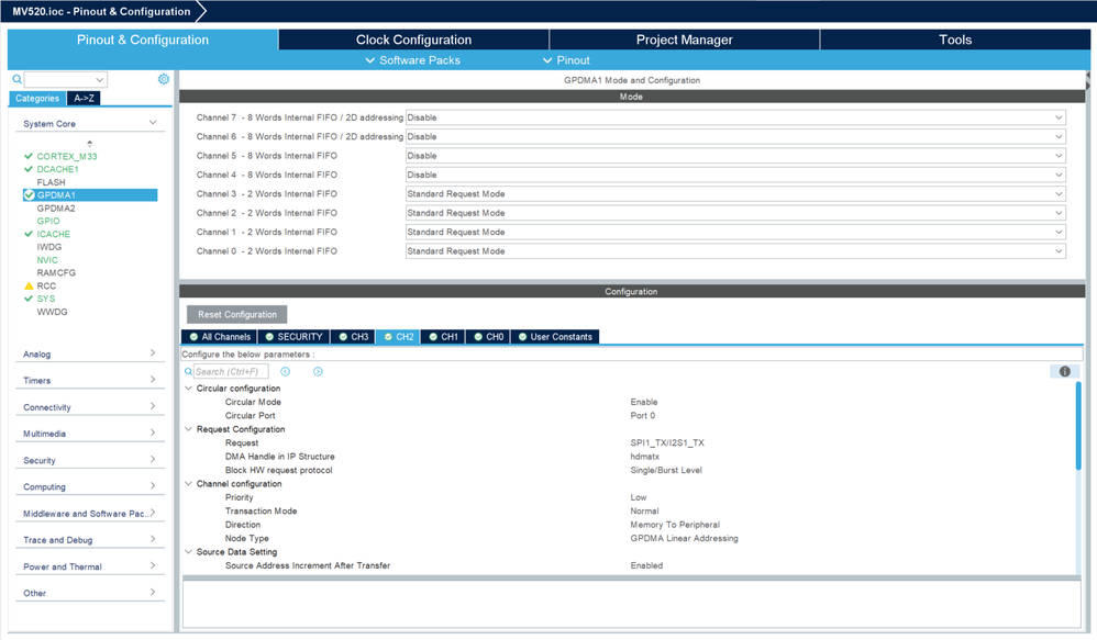

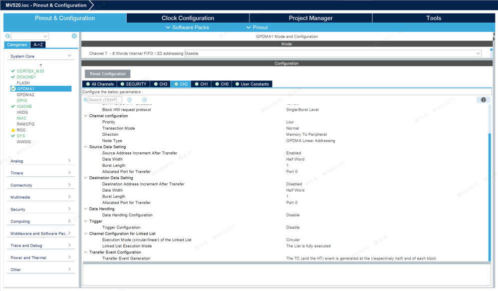

My Configuration of STM32CubeMx as shown in the figure1 and 2.
figure1
figure2

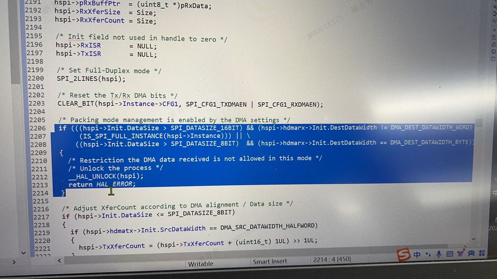

I call the function of HAL_SPI_TransmitReceive_DMA(), it comes to line 2212 of program and return HAL_ERROR then.

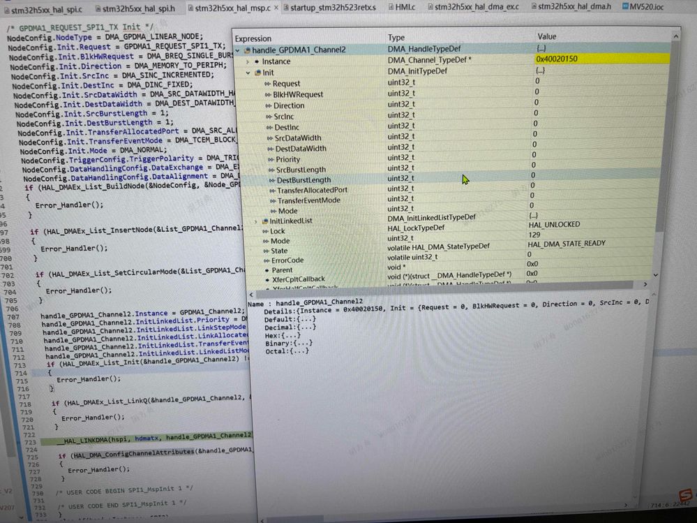

I debug the program and find the value of hspi->hdmarx->Init.DestDataWidth is 0, so it return the error.
Then I back to check the initialization of spi1 dma. I find that the Init.DestDataWidth of handle_GPDMA1_Channel2 is already 0 before execute statement __HAL_LINKDMA() .
So I guess maybe somewhere my configuration of spi dma is wrong somewhere and I can't figure it out.
Please help me for this question.
Thanks!

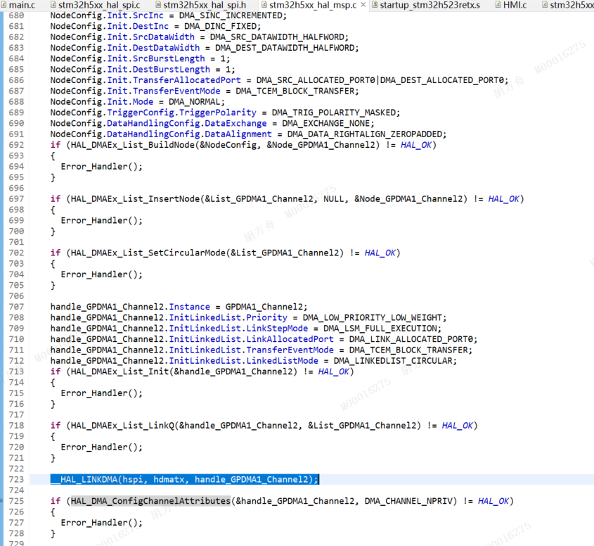

Here is my code and .ioc file
/* SPI1 DMA Init */
/* GPDMA1_REQUEST_SPI1_RX Init */
NodeConfig.NodeType = DMA_GPDMA_LINEAR_NODE;
NodeConfig.Init.Request = GPDMA1_REQUEST_SPI1_RX;
NodeConfig.Init.BlkHWRequest = DMA_BREQ_SINGLE_BURST;
NodeConfig.Init.Direction = DMA_PERIPH_TO_MEMORY;
NodeConfig.Init.SrcInc = DMA_SINC_FIXED;
NodeConfig.Init.DestInc = DMA_DINC_INCREMENTED;
NodeConfig.Init.SrcDataWidth = DMA_SRC_DATAWIDTH_HALFWORD;
NodeConfig.Init.DestDataWidth = DMA_DEST_DATAWIDTH_HALFWORD;
NodeConfig.Init.SrcBurstLength = 1;
NodeConfig.Init.DestBurstLength = 1;
NodeConfig.Init.TransferAllocatedPort = DMA_SRC_ALLOCATED_PORT0|DMA_DEST_ALLOCATED_PORT1;
NodeConfig.Init.TransferEventMode = DMA_TCEM_BLOCK_TRANSFER;
NodeConfig.Init.Mode = DMA_NORMAL;
NodeConfig.TriggerConfig.TriggerPolarity = DMA_TRIG_POLARITY_MASKED;
NodeConfig.DataHandlingConfig.DataExchange = DMA_EXCHANGE_NONE;
NodeConfig.DataHandlingConfig.DataAlignment = DMA_DATA_RIGHTALIGN_ZEROPADDED;
if (HAL_DMAEx_List_BuildNode(&NodeConfig, &Node_GPDMA1_Channel3) != HAL_OK)
Error_Handler();
if (HAL_DMAEx_List_InsertNode(&List_GPDMA1_Channel3, NULL, &Node_GPDMA1_Channel3) != HAL_OK)
Error_Handler();
if (HAL_DMAEx_List_SetCircularMode(&List_GPDMA1_Channel3) != HAL_OK)
Error_Handler();
handle_GPDMA1_Channel3.Instance = GPDMA1_Channel3;
handle_GPDMA1_Channel3.InitLinkedList.Priority = DMA_LOW_PRIORITY_LOW_WEIGHT;
handle_GPDMA1_Channel3.InitLinkedList.LinkStepMode = DMA_LSM_FULL_EXECUTION;
handle_GPDMA1_Channel3.InitLinkedList.LinkAllocatedPort = DMA_LINK_ALLOCATED_PORT1;
handle_GPDMA1_Channel3.InitLinkedList.TransferEventMode = DMA_TCEM_BLOCK_TRANSFER;
handle_GPDMA1_Channel3.InitLinkedList.LinkedListMode = DMA_LINKEDLIST_CIRCULAR;
if (HAL_DMAEx_List_Init(&handle_GPDMA1_Channel3) != HAL_OK)
Error_Handler();
if (HAL_DMAEx_List_LinkQ(&handle_GPDMA1_Channel3, &List_GPDMA1_Channel3) != HAL_OK)
Error_Handler();
__HAL_LINKDMA(hspi, hdmarx, handle_GPDMA1_Channel3);
if (HAL_DMA_ConfigChannelAttributes(&handle_GPDMA1_Channel3, DMA_CHANNEL_NPRIV) != HAL_OK)
Error_Handler();
/* GPDMA1_REQUEST_SPI1_TX Init */
NodeConfig.Init.Request = GPDMA1_REQUEST_SPI1_TX;
NodeConfig.Init.Direction = DMA_MEMORY_TO_PERIPH;
NodeConfig.Init.SrcInc = DMA_SINC_INCREMENTED;
NodeConfig.Init.DestInc = DMA_DINC_FIXED;
if (HAL_DMAEx_List_BuildNode(&NodeConfig, &Node_GPDMA1_Channel2) != HAL_OK)
Error_Handler();
if (HAL_DMAEx_List_InsertNode(&List_GPDMA1_Channel2, NULL, &Node_GPDMA1_Channel2) != HAL_OK)
Error_Handler();
if (HAL_DMAEx_List_SetCircularMode(&List_GPDMA1_Channel2) != HAL_OK)
Error_Handler();
handle_GPDMA1_Channel2.Instance = GPDMA1_Channel2;
handle_GPDMA1_Channel2.InitLinkedList.Priority = DMA_LOW_PRIORITY_LOW_WEIGHT;
handle_GPDMA1_Channel2.InitLinkedList.LinkStepMode = DMA_LSM_FULL_EXECUTION;
handle_GPDMA1_Channel2.InitLinkedList.LinkAllocatedPort = DMA_LINK_ALLOCATED_PORT0;
handle_GPDMA1_Channel2.InitLinkedList.TransferEventMode = DMA_TCEM_BLOCK_TRANSFER;
handle_GPDMA1_Channel2.InitLinkedList.LinkedListMode = DMA_LINKEDLIST_CIRCULAR;
if (HAL_DMAEx_List_Init(&handle_GPDMA1_Channel2) != HAL_OK)
Error_Handler();
if (HAL_DMAEx_List_LinkQ(&handle_GPDMA1_Channel2, &List_GPDMA1_Channel2) != HAL_OK)
Error_Handler();
__HAL_LINKDMA(hspi, hdmatx, handle_GPDMA1_Channel2);
if (HAL_DMA_ConfigChannelAttributes(&handle_GPDMA1_Channel2, DMA_CHANNEL_NPRIV) != HAL_OK)
Error_Handler();
