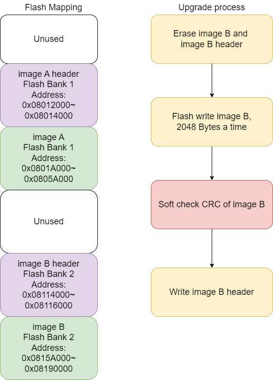

I have an IAP project which have image A and image B. Image A is on flash bank1 and image B is on flash bank 2. When I run image A and upgrade image B, I will trigger the bug when doing soft CRC. The system is running on freertos.

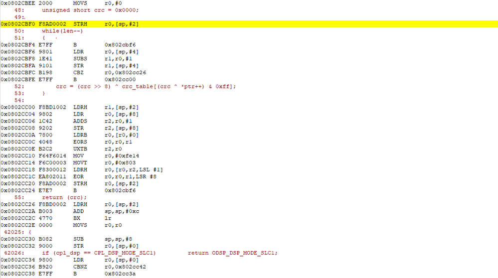

The phenomenon is that when I do soft crc after upgrading image B, the PC counter will stuck at SPI2 error handler when running
while(len--)
crc = (crc >> 8) ^ crc_table[(crc ^ *ptr++) & 0xff];
}But all SPIs are deinit at that time. If I remove the code for SPI2 error handler. hander. It will enter NMI Handler. Apparently PC takes a wrong pointer value, just like a wild pointer.
I checked assembly and thought the only possibility to make PC out of control is
MOV r0,#0xfe14
MOVT r0,#0x803
LDRH r0,[r0, r2, LSL, #1]Then, with only adding volatile to crc variable, the soft CRC check can be successfully done when upgrading image B from image A.
volatile unsigned short crc = 0x0000;So it seems like volatile is necessary to avoid triggering this bug. But theoretically there should not be any bug with my original code.
BTW, if I simply call the software check without erasing/writing flash, it can always work.
