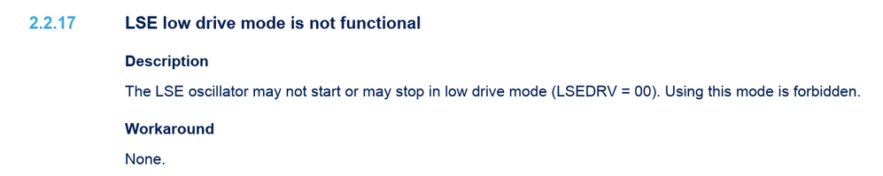

Hi, try setting the LSE drive medium or hi (i use always hi - most reliable .)
And if any doubt - see H563 errata :

Thanks for bringing this to my attention, I was not aware of that.
I did some quick tests with drive setting HIGH, but I could still reproduce the issue of LSE not starting, after connecting/disconnecting SWD.
So I'll keep the backup domain reset as a workaround, but I will also be using HIGH drive mode to be sure.
