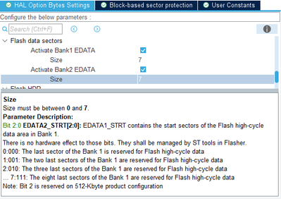

I am using the Cube Code Generator, within the STM32CubeIDE (version 1.13.1) for an STM32H563, and have configured the Flash Data Sectors to use the maximum 8 sectors per bank for EDATA. The valid range for the EDATA sector size is 0 - 7, as shown below. I believe there is a bug within the generated code for the EDATA sector size.
STM32CubeIDE Code Generation EDATA Size Range
When I choose the maximum value of 7, and follow it through the generated MX_FLASH_Init() function, I am finding that the resulting sector size that is written to the FLASH->EDATA1R_PRG and FLASH->EDATA2R_PRG registers is 1 less than what I would expect. This is because the FLASH_OB_EDATAConfig() function subtracts 1 from the EDATASize that is passed in. I have temporarily patched this by adding 1 to the EDATASize generated in MX_FLASH_Init().

2024-07-19 8:27 AM
Thank you for the reply.
I am using CubeMX version 6.11.1, and the information text when selecting the "Size" field of the EDATA section (in FLASH > Flash data sectors > Activate BankX EDATA) is as follows.
Parameter Description:
Bit 2:0 EDATA1_STRT[2:0]: EDATA1_STRT contains the start sectors of the Flash high-cycle data area in Bank 1.
There is no hardware effect to those bits. They shall be managed by ST tools in Flasher.
0:000: The last sector of the Bank 1 is reserved for Flash high-cycle data
1:001: The two last sectors of the Bank 1 are reserved for Flash high-cycle data
2:010: The three last sectors of the Bank 1 are reserved for Flash high-cycle data ...
7:111: The eight last sectors of the Bank 1 are reserved for Flash high-cycle data
Note: Bit 2 is reserved on 512-Kbyte product configurationGlad to hear that this should be addressed though.
