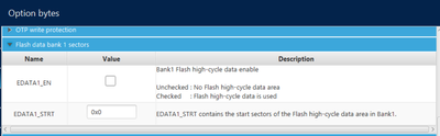

I tried to access 0x0900A800 by CubeProgrammer but it showed Data read failed.
But if checked the EDATA1_EN option by CubeProgrammer. It worked.
