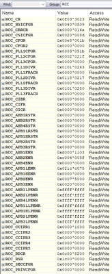

Unpack the RCC registers

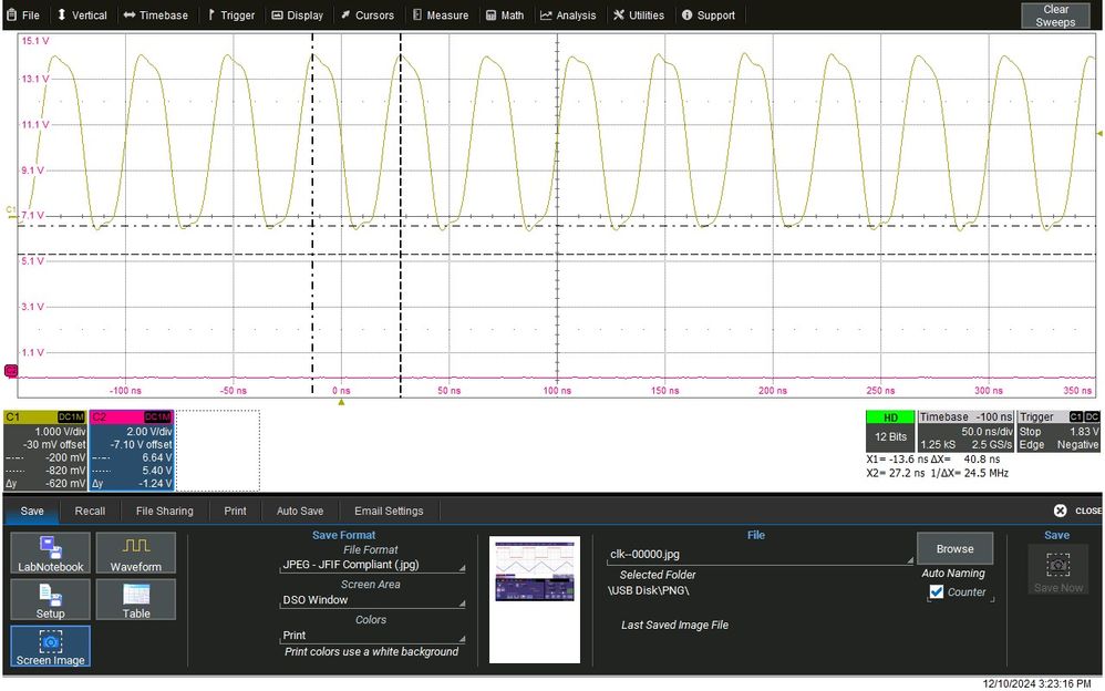

Export the internal clock via PA8 / MCO

Here are registers:

clocks

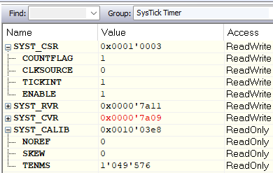

And main clock selection:

0x7A11 * 8 ~ 249992 seems Ok
