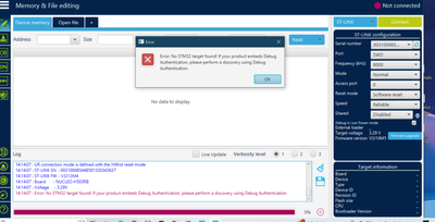

I Using Keil software the Target does not detect it, but the Board LEDs or working well PWR led Glow Properly, and COM LED glows Red color only
Please help to resolve the problem

2024-04-01 1:46 AM
Hello, @STTwo-32
I tried it.
can you Help me to resolve the probelm. what should do next I'm so confused.
