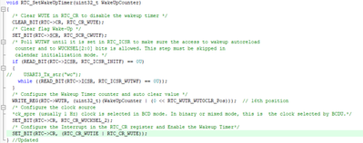

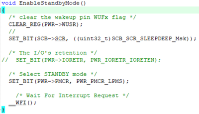

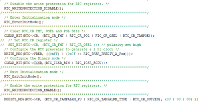

Hi @PGump.1,
actually, I am Try to writing a bare metal code, not using hal code, I set proper prescaler value and WUT value(its not set properly)
This enables the standby mode and wakeup pin
this step is RTC init
stand by mode enable
wakeup pin enable
set wakeup time

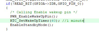

this pictures are used to set standby mode and enable wakeup pin, set the wakeup timer.
and one more thing, WUT value is not updating during wakeup time setup process, i can't understand this concept
could you please explain me.
Thanks.

You say the timer wakes up at 10 second intervals. It looks like your code sets the timer to 60 seconds. Is that the problem?
What is PA0 connected to? A switch?
