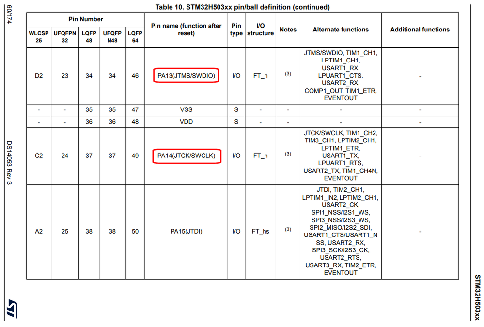

@Ravichandran wrote:when configuring GPIOs in PORT A and integrating it with data pulses, the following error occurs stating the target device not responding.
The SWD Debug pins are on Port A:
Therefore, if your "configuring GPIOs in PORT A" includes PA13 and/or PA14, then that is going to break the debugger connection.

We've filtered out pins that we can't use and are left with only 5 pins namely PA0, PA1, PA2, PA6 and PA15. We have rejected PA3 since in our EVM Nucleo 64 MB1814B, it is configured as UART/USART as default. Remaining pins we've rejected since they are not 5V tolerant

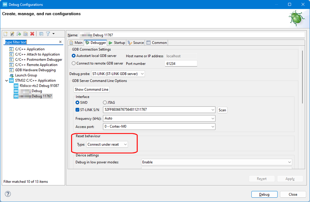

Do you connect under Reset?
2024-08-09 3:07 AM
Can you kindly explain what you mean by connecting under Reset so that we can understand.
2024-08-09 3:33 AM
https://community.st.com/t5/stm32cubeide-mcus/debug-configuration/td-p/281735
2024-08-09 3:40 AM
Yes Andrew, we have been using that debug configuration
