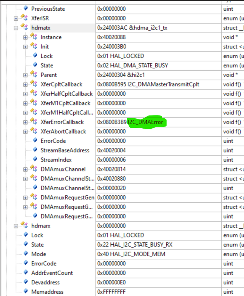

Dear all, in my application I want to send constantly data to an external I2C device in DMA mode. For this I use the function HAL_I2C_Mem_Write_DMA. I have my ADCs and SPI correctly working with DMA but with the I2C I get the error I2C_DMAError in the XferErrorCallback. I have set up the DMA in Circular mode and run the function before the While(1) loop. I can see the I2C clock being sent.
I use the function as follows:
HAL_I2C_Mem_Write_DMA(&hi2c1, I2C_DEVICE_ADD, DEST_ADDRESS,I2C_MEMADD_SIZE_8BIT,(uint8_t*)i2c_data,10);

these are the registers:

Hi Imen, thanks, sorry, I accepted the solution by mistake.
I just realised that when in Normal mode, the interface seems to work. But the xfer ErrorCallback is always I2CError. D and I caches are disabled for the moment being.
