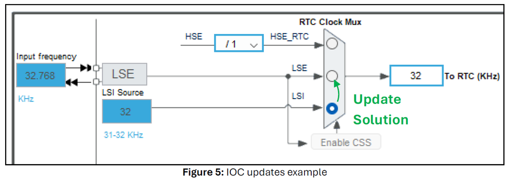

Thank you for the detail and patience @STOne-32@unsigned_char_array, we were able to resolve the situation! Our project was using the LSI within the MSP -
Solution:
void HAL_RTC_MspInit(RTC_HandleTypeDef* hrtc)
  RCC_PeriphCLKInitTypeDef PeriphClkInitStruct = {0};
  if(hrtc->Instance==RTC)
    /** Initializes the peripherals clock
    PeriphClkInitStruct.PeriphClockSelection = RCC_PERIPHCLK_RTC;
    PeriphClkInitStruct.RTCClockSelection = RCC_RTCCLKSOURCE_LSE;  // <- Originally 'RCC_RTCCLKSOURCE_LSI'
    if (HAL_RCCEx_PeriphCLKConfig(&PeriphClkInitStruct) != HAL_OK)
      Error_Handler();
    /* Peripheral clock enable */
    __HAL_RCC_RTC_ENABLE();
    __HAL_RCC_RTCAPB_CLK_ENABLE();
 Our IOC file wasn't in-sync with our project; is it supposed to be? Here was the update to apply with the IOC -
Thank you guys!

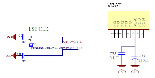

Hi STOne-32, here is our problem in further detail. -
Target:
  • RTC for continuous operation & counts through Vdd power cycles
Circuit:

Dear @jreina
thanks for the details . Just wanted to understand what means :
  1. RTC signal is visible for steps #1-3 above ?
is it visible for all steps from 1 to 3 including 2?
if possible to activate the output on PC13 and monitor the LSE clock in continuous way ? As PC13 is powered by backup domain and we should see what happens . Is you can try to change and LSE drive level to low as well to debug further .

I don't see an external charging circuit. Have you enabled internal charging in software?
Reference manual:
VBAT battery charging
When VDD is present, it is possible to charge the external battery on VBAT through an
internal resistance.
The VBAT charging is done either through a 5 or a 1.5 kΩ resistor, depending upon the
VBRS bit value in the PWR_BDCR register.
The battery charging is enabled by setting VBE bit in the PWR_BDCR register. It is
automatically disabled in V BAT mode
If you have enabled charging, what is the voltage on the VBAT pin?
RC-time constant if you use 1500Ohm and 0.22F is 330 seconds. I don't know what voltage the RTC needs so it could be even longer than this. I would use an external charging circuit (a diode with a series resistor should suffice).
