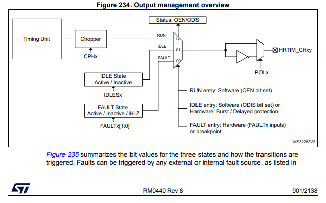

eg, for the High Resolution Timer (HRTIM):
have you also looked at Application Note AN4013, Introduction to timers for STM32 MCUs:

2024-04-24 2:20 AM

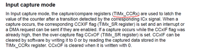

2024-04-24 2:33 AM
Thanks Andrew for your quick support.
Yes this will work fine for for pwm.
Also input capture compare for any pwm incoming signal will use below TIMx_CCRx
2024-04-24 2:53 AM
Hope i can see CCR pins in datasheet for input pwm capture
