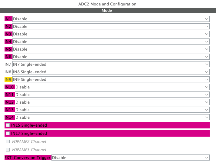

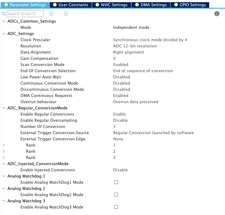

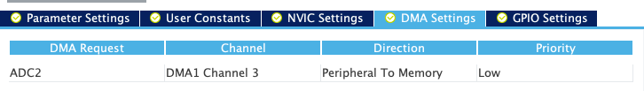

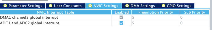

Below pictures are the ADC config in CubeMX. It is a Ranks 3 setup for 3 ADC channels. The error happens at the ADC_Enable() in the HAL_ADC_Start_DMA() function call. It always timeout in the ADC_Enable() while loop and return HAL_ERROR. The HAL_ADC_Start_DMA() is called in freeRTOS threads every half second. This function used to work without SCB->VTOR = 0x8004000 and bootloader.
