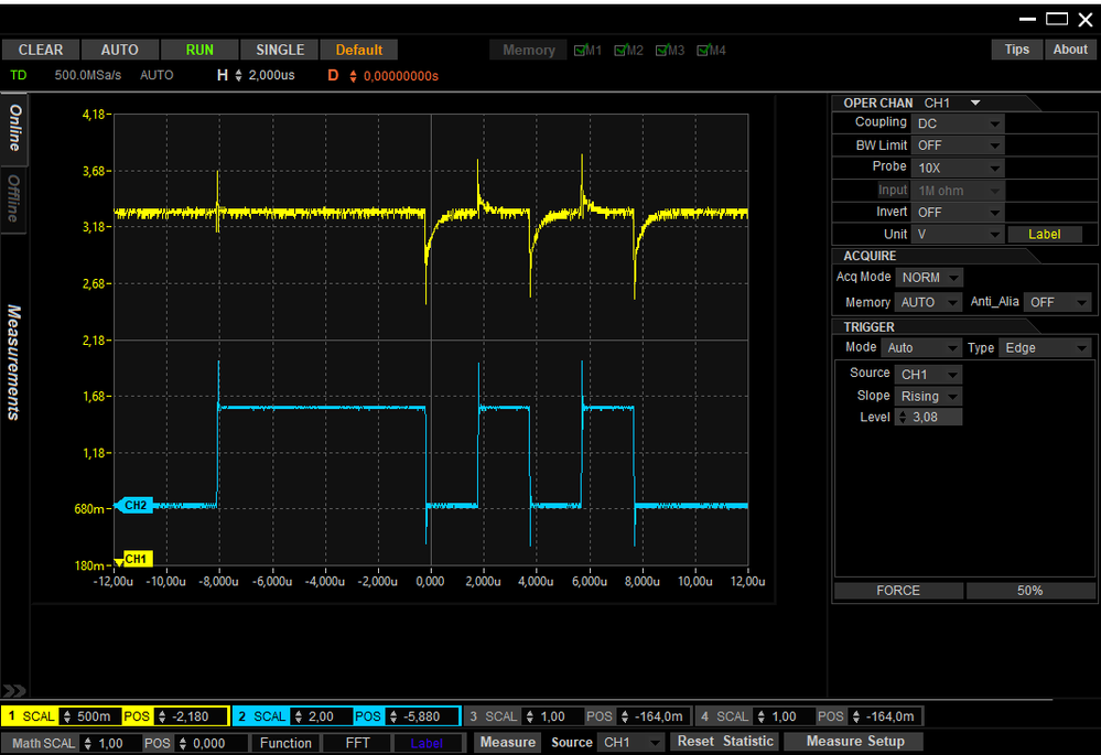

I'm trying to connect my MPU6500 to my Nucleo f411re board with the SPI Protocol.
The MPU6500 is working correctly because I tested it with an Arduino and it worked as expected.
I'm using SPI2 with the Pins PB15, PB14 and PB13.
But for some reason I can't get it to work on the STMF411. Infact the clock isn't even working correctly as you can see on the oscilloscope.
Yellow is the Clock and Blue is MOSI. (Yellow is scaled to 500mv and Blue to 5v)
Maybe my configuration is wrong?
I hope someone could help me it and spot the mistake.
Thanks in advance!

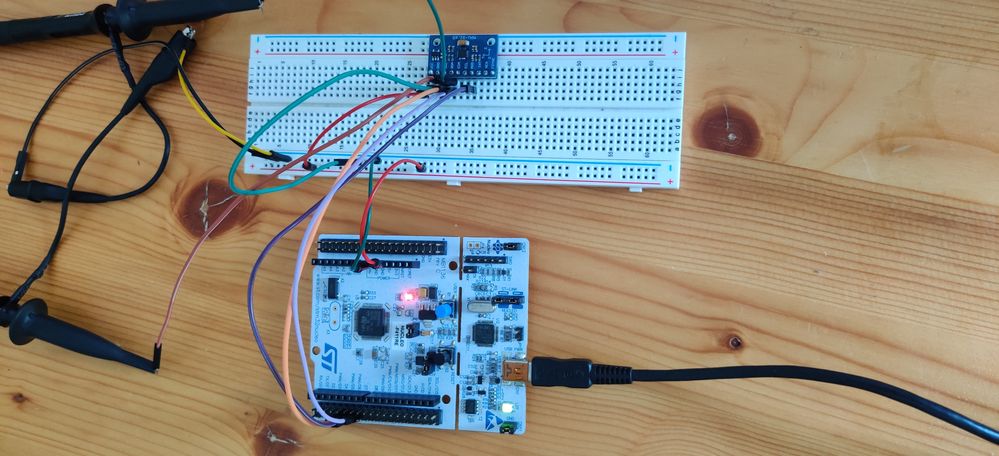

2020-06-19 4:47 AM
If I just set the connected Pins to Output and toggle them manually everything works as expected.
Furthermore the following code works fine as well.
I also included a picture of the wiring. I Just connected the MPU6500 to the board nothing else.

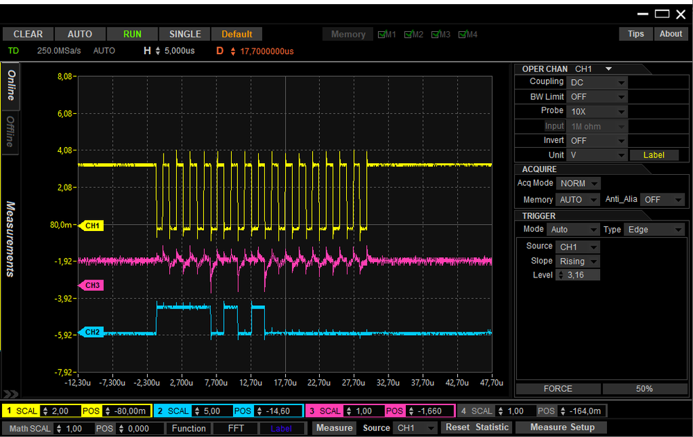

Yes that was the mistake, thank you very much.... After using the correct bits for AF5 the clock worked without a problem. The SPI sending now works as expected but sadly I don't receive anything.
Maybe someone knows something about the MPU6500 and why it's not working correctly?
I also tried to reduced the cable length and reduced the speed of the GPIO Pins but the response still looked likes in the following image of the oscilloscope.
Yellow: Clock, Blue: MOSI, Purple: MISO
2020-06-19 12:02 PM
I look into the CMSIS Register thank you very much.
2020-06-19 12:25 PM
I don't see you toggling the CS pins anywhere. You need to do this so the chip knows where the transmission starts.
