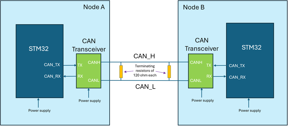

Could you confirm again you have this structure for this test?:

2024-11-26 5:36 AM
@mƎALLEm ,
Yes, the connections you mentioned are the same on my end. I have verified them multiple times.
Answer 1: Yes, the power supply is as expected VCC (5V) on pin3 and VIO (3.3V) on pin 5.
Answer 2: Yes, the wiring, termination resistors and connection are intact.
P.S.: When I connect a CAN analyzer to the bus, communication works correctly without any issues. This confirms that both the communication and physical connections are functioning properly
