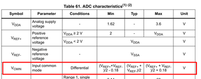

> limiting factor seems to be aperture jitter about 120 ps. PLL settings have noticeble impact on the performance
Interesting, thanks.
Are you aware of the common-mode voltage requirement for differential use of the STM32 ADC?
I'm not sure what the consequences of not maintaining it exactly are - and maybe they become relevant only in some marginal cases - but I thought I'd point it out.
2023-11-10 6:08 AM
It's not "visible", but THS7373 is special video driver - not like common OPA. It has some bias circuitry with DC offset internaly, so having 3.3M on inputs it has 1.60V on the outputs. Differential driver is perfectly balanced.
I have hard time, to find good adc driver for stm32 product, because of theirs vulnerability to input overdriving - this limits selection down to 3.3V high speed (slew rate especially > 400 V/usec) low distortion (<-50dB 20 MHz) and R2R. Not many parts even highly overpriced from AD or TI could satisfy this requirements. THS7373 is the best, cost only $ 0.5
2023-11-10 11:26 PM
Oh, okay, I did not check that indeed. Thanks.
