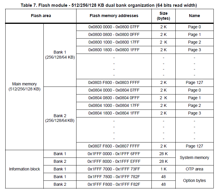

I'm trying to understand how flash memory is organized for STMN32G474QB or STM32G474QC flash. I don't have the micros till now so I cannot do any test to understand that.
From the RM0440 manual it seems both are in category 3 device. But when I look at the table displaying the flash organization:
0693W00000KZtUHQA1.pngthen I'm confused if they are organized as a single bank when, dual bank is selected (256 Kbyte for QC and 128 Kbyte for QB), or divided in two bank but I can't figure out which size would have each bank in that case. I guess that only one the first bank is enabled but I'm not sure about that. Or simply there is no option for dual bank for those devices? In that case each page would be 4 Kbyte size...
Hope someone can help me to cancel my doubts! :smiling_face_with_smiling_eyes:

In dual bank mode:
For a 256kB flash chip, you have two 128kB banks with a gap in the middle.
For a 128kB flash chip, you have two 64kB banks with a gap in the middle.
Page size is always 2kB.
Banks always start at the location given in the table.
In single bank mode, you have all the memory at 0x08000000 with no gap.
