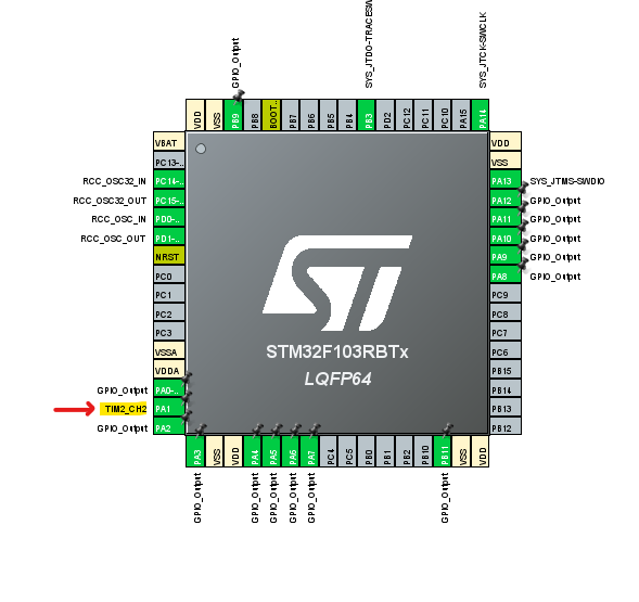

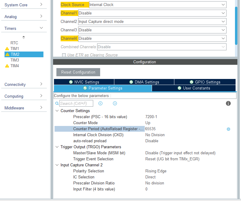

I measure the frequency from sensor using the Timer Input Capture mode.
I set the timer can read minimum 1Hz.
72M / 7200/65535 = 0.15Hz

}But It can't measure the frequency. (When input frequency 1Hz,..)
What's wrong my code and setting?
