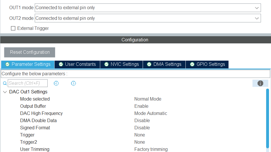

Hi guys:
My project DAC setting as below:
And my project that initial and code as below, it's works on EVM board (STM32G474RETX), but now works on STM32G474MCT3TR, does anyone encounter this situation?

2025-02-18 1:49 AM
So, where's the problem, and what are its exact symptoms?
How is reference (VREF+ pin) set up and what voltage do you measure there?
How are the DAC pins connected? Do you take into consideration their limited output current?
Read out and check/post content of DAC and relevant GPIO registers.
2025-02-18 4:27 AM
The symptoms is that I can't control the DAC output 1.65v for the STM32G474MCT3TR MCU, I measure the VREF = 3.3v, VDDA also 3.3v, but still no DAC output 1.65v. I measure the DAC output by contact the STM32G474MCT3TR MCU' pin PA4 & PA5. Finally I check the DAC registers also correct too.
