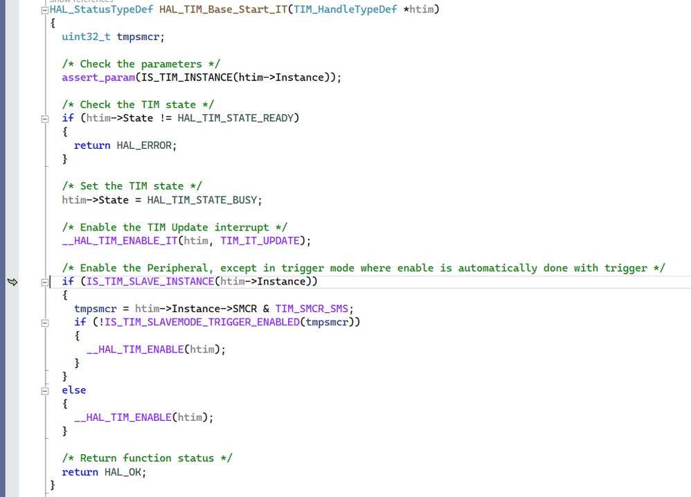

I have a problem with interrupts on my STM32G474VEH6 based board. Timer 6 generates an interrupt every 1ms.
Program crash at HAL_TIM_Base_Start_IT(&htim6);

The program enters a function and gets stuck inside without exiting.
Nothing happens. Еverything is stuck.
The system is not reset.
When I do a step by step in the HAL_TIM_Base_Start_IT() everything goes through but the interrupt doesn't fire.

When I stop the MCU it stops at "IS_TIM_SLAVE_INSTANCE(htim->Instance)".
One more point: if I try to "reset the device" (not reload), the system won't enter for debugging, it looks like the MCU won't start after the reset. The same happens if I check "Reset device after programming"
