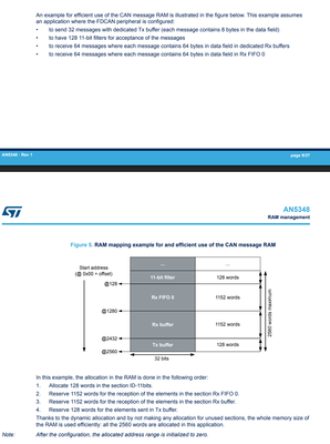

2025-12-30 5:26 AM
They share the same RAM.
You can check this graph in AN5348
