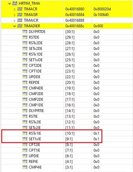

I have enabled the interrupts for channel set (SETx1) and channel reset (RSTx1) by setting bits RSTx1IE and SET1xIE. I am trying to drive the outputs to active-inactive state via software by writing to SST and RST bits of the TIMERA.

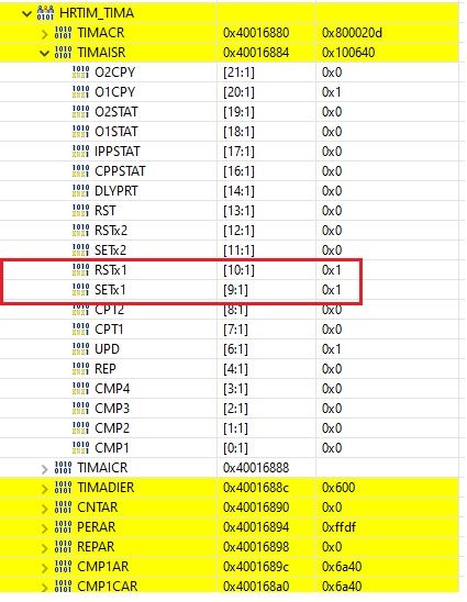

Inside the TIMAISR register I can see the SETx1 and RSTx1 interrupt event flags are set. This indicates the fact that output active-inactive state changes are driving the interrupts.

Hi Vincent,
You mean to say the below bits?
They are indeed set.
0693W00000QKuw0QAD.jpgAlso, please note the below flags are set that tell interrupt occurred:
