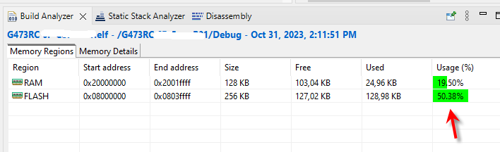

I have a STM32G473RC MCU with 128k RAM and 256k Flash.
As long as the Flash File stays below the size of 128k all works fine. I can develop, test and debug with CubeIDE. As soon as the flash file becomes larger than 128k, I can no longer debug the Software, because the Launch of the debugger exits with an error message:

I have checked the MCU on the PCB: it IS a G473RC. I have checked the connection with Cube Programmer, it says the device has 256k Flash. The Linker Script is correct (128k RAM, 256k Flash) - it is orignal as CubeMX created it, i did not change it. The MCU in the CubeIDE Project is G473RC. The Project compiles without errors and warnings. So far all seems to be correct, which brings me to the asumption, that there might be a bug in the startup script.
