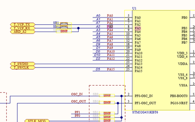

As MasterT already said, if you are using a Nucleo board, PA3 is likely used for serial communication to the ST-LINK:
