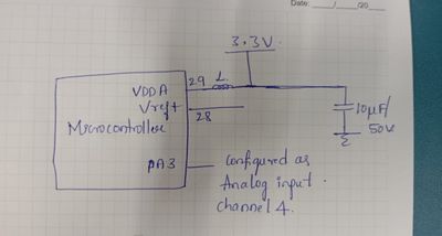

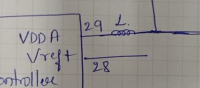

So VREF+ isn't connected to anything? Seems like an issue to me. Should have caps on there.

The ADC is a multiplexer. Hardware downstream of the pin is the same for all channels, so this must be related to what's connected to the pin (or a misinterpretation). Show the hardware schematic and connection details and a plot of the data coming out if possible.

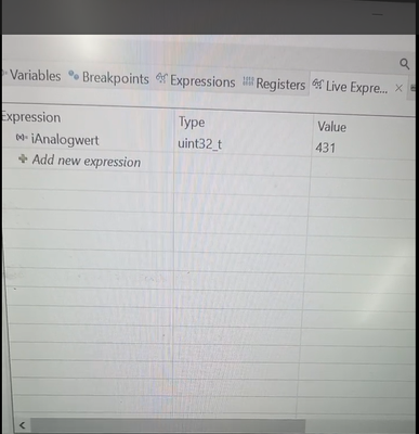

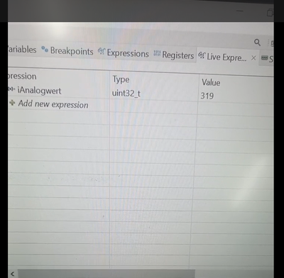

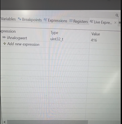

we have given 200mV and we need to get 400 counts, but we are getting values in between 250 to 430 counts.
