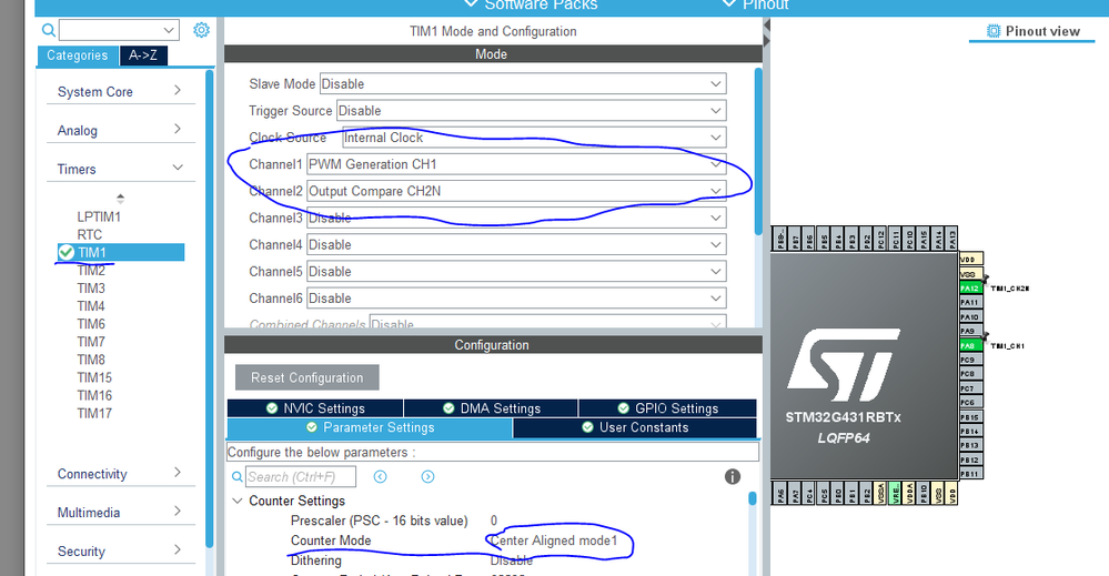

On the 'G4 you could use Asymmetric/Combined mode to arbitrarily phase-shift one or two waveforms, but for this particular application it's probably simpler to use plain PWM and center-aligned (up-down counting) mode.

2023-01-10 6:57 AM
I believe he was referring to cubeMX
2023-01-10 7:01 AM
@Community member was refferring to this i believe.
Now you could play with TIM1->CR 1 and TIM->CR2(complement) to get what you wanted.
2023-01-10 1:08 PM
Interested in this too.
But such configuration outputs signals to separate channels (TIM1_CH and TIM1_CH2N). Can they be coupled to protect outputs from occasional high levels on both leading to short circuit?
In other words is it possible to output 30% duty on two pins, 180 degrees phase-shifted and protected with deadtime insertion using TIM1?
