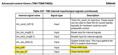

I'm looking into calculating the timings for the brk filters for the TIM1 periphery. Mentioned there is the "tim_ker_ck" and the "tim_pclk" respectively.
I cannot seem to find any information on where these come from.
The clock tree in the RM says that TIM1 is connected to the APB2 using PCLK2, however there's nothing on how PCLK2 translates to tim_ker_ck or tim_pclk.

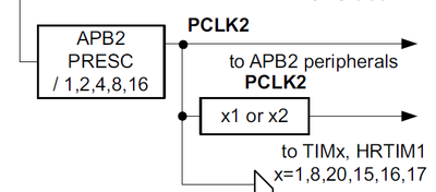

tim_pclk = PCLKx, the clock ratio can be  1,2,4,8 and 16 of the AHB clock source HCLK.
tim_ker_clock is derived from the PCLKx=tim_pclk source, it is always 1x or 2x of tim_pclk.

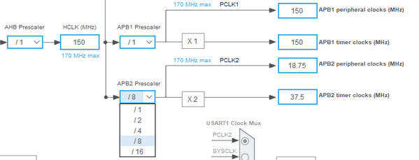

tim_pclk tim_ker_ck is either 1x the APB clock if the APB prescaler is /1, else it's 2x the APB clock.

Below we are talking about the tim_ker_ck, as mentioned by @TDK, it is either PCLK2 x1 or PCLK2 x2:
  • the kernel timer clock frequencies are automatically defined by hardware. If the APB prescaler equals 1, the kernel timer clock frequencies are set to the same frequency of the APB domain, otherwise, they are set to twice (×2) the frequency of the APB domain ( see RM0440, section 7.2.13 Timer clock).
  • RM0440, Figure 17. Clock tree, shows the tim_ker_ck

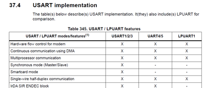

To be constructive, what can be done easily is to add one table in each chapter that summarizes the implementation features of all timers as one for USART/UART/LPUART.
However, I didn't catch you point  (e.g. UART/USART - although that in turn is itself an extremely bad choice of naming made even worse by propagating it into the "libraries" and, what's worse, into the CMSIS-mandated device headers).
Can you explain ? give explicit examples ... it could be matter of enhancement for our firmware !!!

UART vs. USART, I've written about it here.

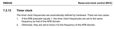

> If so, it should be possible to clearly state what that value is, 1x or 2x.
tim_pclk is the APB clock of the APB bus, on which is given timer located (see the block diagram, first figure in Datasheet; or peripheral register boundary addresses table in System and memory overview chapter in RM, usually 2nd chapter)
tim_ker_clk is described as Timer clock in the RCC chapter of RM, e.g. for 'G4:
