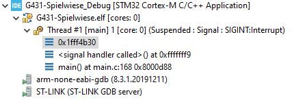

}My problem is that the program hangs up at the wait for SPI transmission completed
// Wait for SPI transmission completed
while (TRANSFER_WAIT == tSpiTransferState)
}The DMA interrupt handlers (neither channel 1 nor channel 2) are not called...

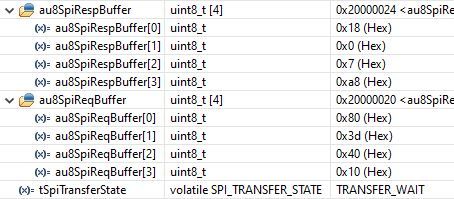

Nevertheless, if I halt the MCU, everything seems to be done correctly.

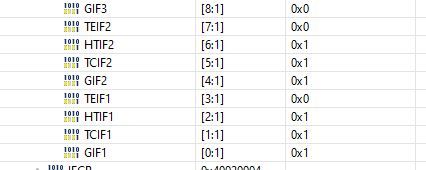

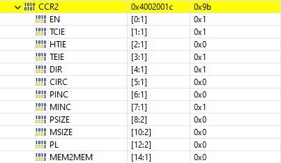

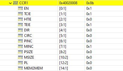

DMA channels are configured correctly (including the transmission complete interrupts enabled)
And the transmission complete flags on the DMA channels are set.

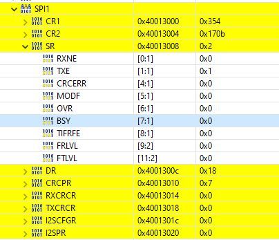

Also the SPI status register looks good.
And even the response buffer shows the actually received data.
The only strange thing is that the DMA interrupt handlers are not triggered...

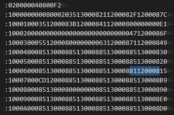

2022-02-10 3:07 AM
> What could be the reason, that in my application the bootloader will be entered?
I don't know. Check SCB->VTOR.
Check your BOOT0 pin and setting of the relevant option bits.
Check SYSCFG_MEMRMP.

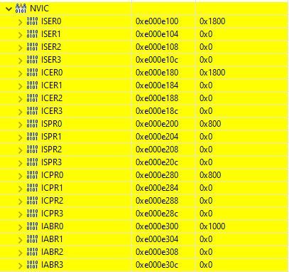

2022-02-08 2:37 PM
- interrupts not enabled in NVIC - read out NVIC registers to check
- current execution priority higher than interrupts' priority - incorrectly finished previous interrupt or incorrectly set up RTOS
- globally disabled interrupts
Here is some general checklist.

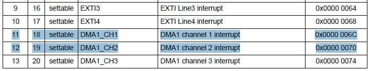

}This is also reflected by the NVIC registers
Additionally I call __enable_irq() before my main while loop.

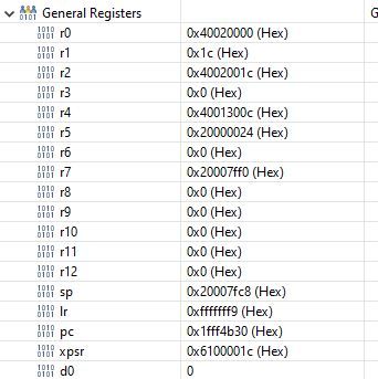

What struggles me, is the set bit in NVIC register "IABR0" which means that an interrupt is active.

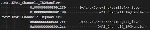

I've cross-checked the name of my interrupt handlers "DMA1_Channel1_IRQHandler" and "DMA1_Channel2_IRQHandler". They match the handlers which are embedded in the interrupt vector table of the file "startup_stm32g431kbtx.s" embedded in this project.
Well then probably it is. Where is the program counter?

2022-02-09 11:07 PM
The program counter is at 0x1FFF4B30.
What does this mean? It is not a "normal" program address...
> Never trust source code - processor executes binary, not the source code. Have a look at the vector table in binary and check that the proper vector is at proper position.
The interrupt vectors I'm interested in are at address 0x0000006C and 0x00000070.
My handler are located at addresses 0x08001280 and 0x080012CC (seen in map-file).
In the output hex file the interrupt vector looks like following picture.
The stored addresses in vector table are different by 1 compared to the addresses in map file. But I've checked that with other standard IRQHandlers like "HardFault_Handler" or "MemManage_Handler". There is the same difference, so from my point of view this seems to be ok.
2022-02-09 11:38 PM
Yes, the vector table is OK.
Cortex-Mx runs permanently in Thumb mode (see some basic ARM history/overview) and bit 0 of code addresses signalize this.
> PC=0x1fff4b30
This is in the system ROM area, a.k.a. bootloader. Check your BOOT0 pin and setting of the relevant option bits.
2022-02-10 1:21 AM
The BOOT0 pin is connected to GND, so the device will boot from flash.
