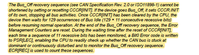

HOT connecting and disconnecting to the CAN bus during communication could result to CAN communication errors. So you need to recover from the bus off state as described in the reference manual:
For example, try this code for example to recover from the bus off state:
if((*FDCAN1).PSR & FDCAN_PSR_BO) /* If the node goes to the Bus-off state */
(*FDCAN1).CCCR &= ~FDCAN_CCCR_INIT; /* Clear CCCR.INIT bit to exit from Bus-off state*/
while (((*FDCAN1).CCCR & FDCAN_CCCR_INIT) != 0); // wait for synchronization
