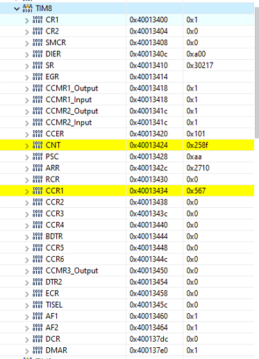

I have a STM32G431 48-pin device which I am using TIM8 for input capture with DMA. I have an external input (PC6) for Ch1 input and am using a software trigger for Ch3.
I have a couple problems, (1) The CCR1 is getting triggered but the corresponding DMA for DMA1_Channel1 is not being triggered and (2) I am using TIM8->EGR = TIM_EGR_CC3G to trigger a capture on CCR3 but CCR3 is not getting loaded.
Is TIM8->EGR = TIM_EGR_CC3G the correct code to trigger a CCR3 capture?

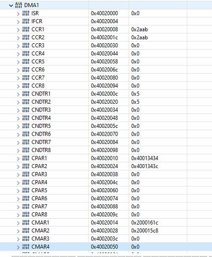

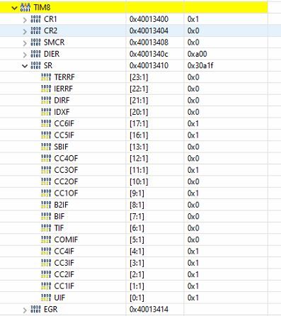

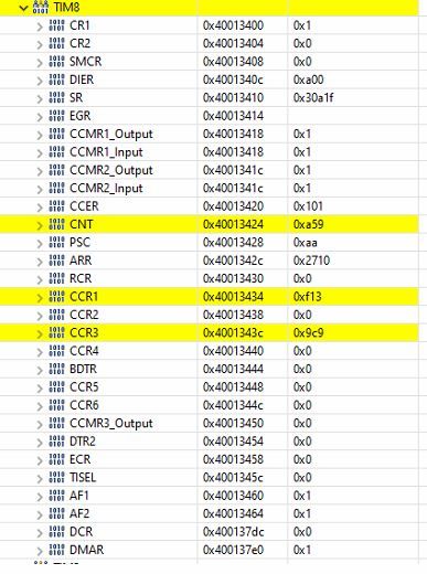

Here is an update. In debug mode I am running a 200Hz logic signal into PC6 for TIM8_CH1 and internally in the main while() loop I am executing TIM8->EGR = TIM_EGR_CC3G every 500ms. In the TIM8 registers I can see that CCR1 and CCR3 are getting loaded and the CC1F and CC3F flags are getting set. However, the ISR for DMA1_Channel1 and DMA1_Channel2 are not getting executed.
Am I correct that this seems to rule out TIM8 as the problem and my problem is somewhere in the DMA peripheral setup? I've collected the readings for registers DMA1 and DMAMUX and starting to analyze those to make sure I set up the DMA correctly.

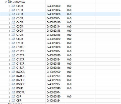

Another update and a request for help! I have had no responses.
I have looked at examples and have read the ref manual and the book "Mastering STM32" and can not track down my problem.
Succinctly, TIM8 flags CC1F and CC3F are getting set but the IRQ for DMA1_Channel1 and DMA1_Channel2 is not getting executed.
DMA is set-up, clocks are enabled, DIER is set and I started both channels using HAL_DMA_Start_IT()
I am including snapshots of the TIM8 reg, DMA1 reg and DMAMUX reg,
2021-05-04 10:23 AM
All DMAMUX registers are 0, it means that there's no routing set up there from TIM to DMA.
2021-05-04 11:03 AM
