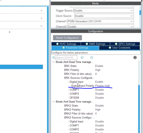

Did you spotted this in the cubeMX config window already?

Hi Javier,
Yes I did the changes as you mentioned in the screen shot in the STMCubeIDE.below is the code
